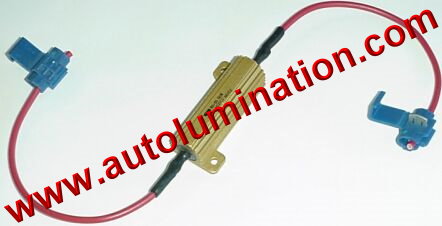

Can you elaborate more on the Load Eq's??
Load EQ's = Load Equalizer
What it does it puts a LOAD on the circuit and heats up like a regular bulb, so that the circuit seems like the regular bulb is still there.
You will need the 6 OHM Load EQ on each side for the rears ;)

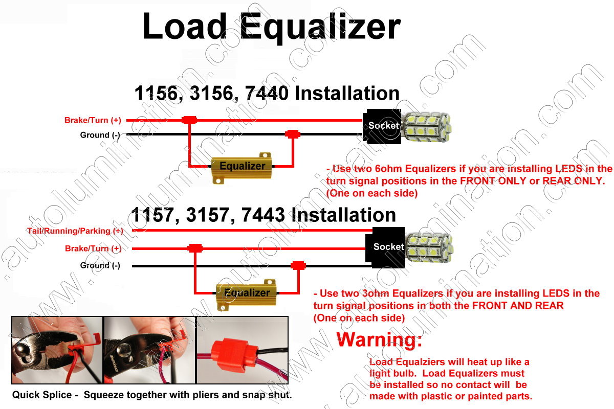

This isn't the BEST diagram but it works ;)
I can look up the wire colors if you dont' know them.
Nope, on the OBS trucks, it doesn't have the LIGHT OUT Feature like other cars/trucks have in the Thermo FLasher.
I even ran the Thermo Flasher with the LED's and they flashed fine and before installing the Load EQ's, I did put the Electronic Flasher in and it didn't change a thing ;)

Yeap, it is just that the OBS trucks are wired differently ;)
I have to pull the wiring diagram and maybe yall can figure it out :sweet
But I do know, without them, it just doesn't work and the Electronic Flasher made no difference at all :dunno
