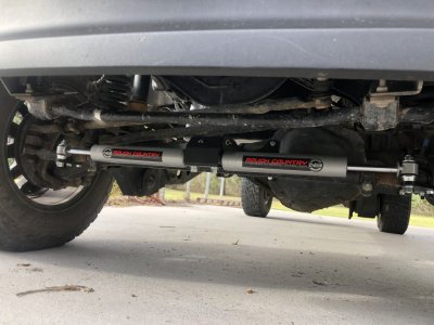

F25186C6-A55A-49B4-8A01-6202A0B38E2C.jpeg 2017 F250 “Ultimate Lariat” FX4
Been fighting the Death Wobble since 15Kmiles. Replaced the steering dampener with a Rough Country HD (dual piston).
Awesome! Now, I’ve only driven it for a little under 100 miles, but it feels like a completely different vehicle. Time will tell as to whether this lasts. But, I have intentionally hit over 2 dozen spots that previously induced the wobble and ...nothing.
If it returns, I’ll be letting y’all know.
