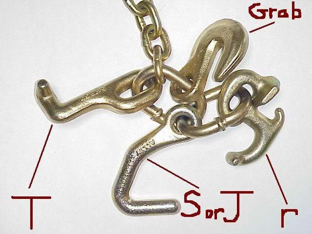

The hook that you see in pics Tommy used are a newly designed "J" hook. It has basically replace the old "S" hook and is more user friendly. You can get them into almost any factor tie-down slot.
You can also get the "T" hook into those same slots, but you have to be able to put the "T" in first and then turn it 90 degrees so the "T" is behind the frame and in the slot securely. So sometimes its easier to put the "J" hook in the factory slots.
As you know, sometimes you hook where you can get the most leverage on each chain. I have hooked on the hitch before when I hauled F250's & 350's on my trailer.
On a truck as big as the F450, you can see it takes up a ramp and a half. Be asured that all 4 chains are pulling in opposite directions of each other keeping that beast firmly planted on the truck. :sweet
A pic is below for those who may be wondering what the heck these "hooks" are we use to tie-down vehicles with.
