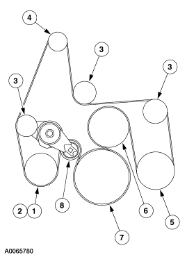

Can anyone explain how to get the Serpentine Belt over the alternator pulley? I've been pulling and cranking so hard that my arms hurt from trying to get belt up far enough to slip over the pulley on the alternator. The only other way I've been able to get it back on was to tilt the alternator down, put the belt over the pulley and then tilt the alternator back up to put the bolts in. Problem with that is that the tension is so tight it's hard to manuever the alternator to line the holes up and with the tension, it's possible to crossthread the threads where the bolts go in. Any ideas is greatly appreciated.

Rotate the drive belt tensioner clockwise and remove the drive belt.
Installation is reverse of removal.
GBBB, this is from the DVD. It might help...:confused:

Here's a photo, FWIW:
Item Part Number Description
1 19D784 A/C clutch pulley
2 19A216 Idler pulley (without A/C)
3 19A216 Belt idler pulley
4 10344 Generator pulley
5 3A733 Power steering pump pulley
6 8A528 Water pump pulley
7 6312 Crankshaft pulley
8 6B209 Drive belt tensioner
6,352
Plano,TX
Bruce I have to say well done on the photos:sweet
And yes the tensioner does take a 1/2" drive breaker bar.

Well after spending 30 minutes trying to get the breaker bar in a spot I could actually get enough leverage on to turn it, and no I couldn't, my brother in-law came over and we were able to pull up enough on the belt to get it back on the alternator and then bolted it down. You would almost have to have the fan off just to get it to a spot where you could actually pull up on it enough to twist it. There's barely enough room to stick the breaker bar in the slot. Barely had enough room to stick my hand down there to grab the belt. Sure is nice to know that car manufactures are making it harder and harder to work on your own vehicle anymore. I think I'll go back to my 79 Ford Bronco where I had enough room to almost stand in the engine compartment to work on it, I sure do miss that thing.
So now I know that I'll be taking it to the dealership to have the belt replaced. What a PITA. My Durango takes me all but 10 minutes change the belt.
