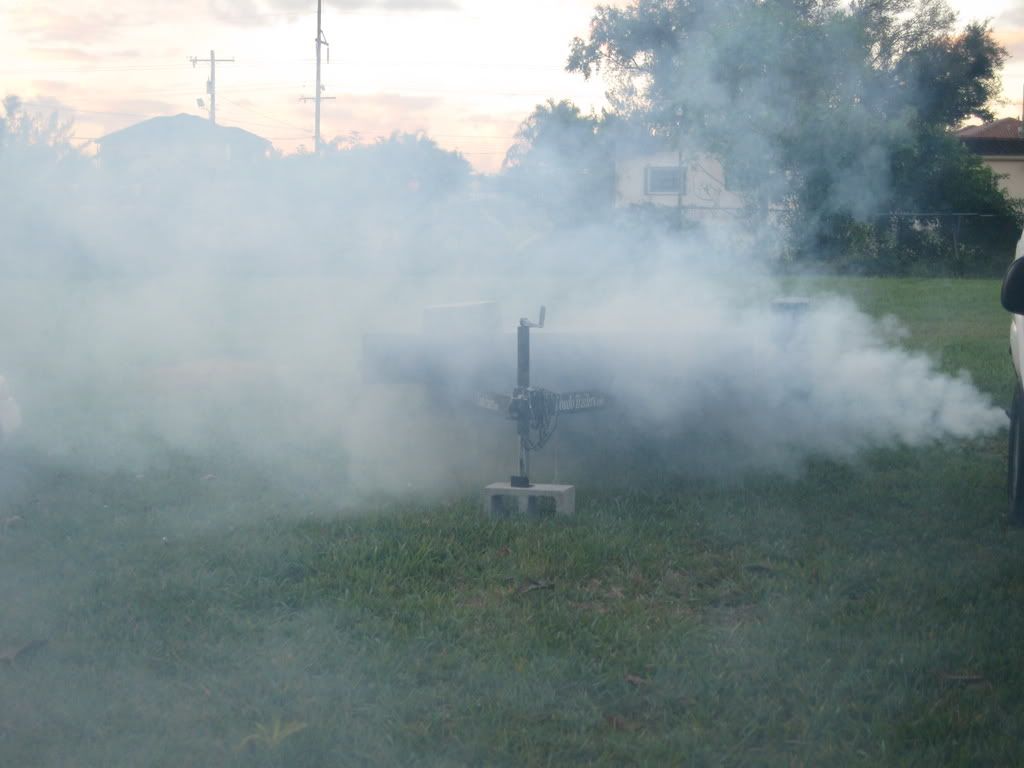

Here's a pic of what i'm dealing with
I'll keep the thread updated with my findings if any :dunno

Is that picture taken at idle from a cold start? You say that smoke never clears up at all?

I'm going to suggest the possibility of a bad injector/o-ring. It's obvious there is too much of something, either oil or fuel, causing the smoke. If you are going to do a compression test, as long as you have the valve covers pulled, might as pull the injectors and inspect them all real good (o-rings, copper gaskets and tip). Wouldn't hurt to get them bench tested also unless you find something glaringly obvious with the o-rings.
BTW, what size trailer ball does that cloud of smoke take??
