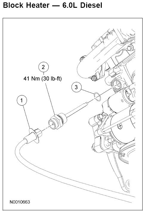

i just went to IH today. $26 and change and out the door. 'I' am just not conviced it is the right 'end'. he did call to confirm tho.
part # ZBL3600008

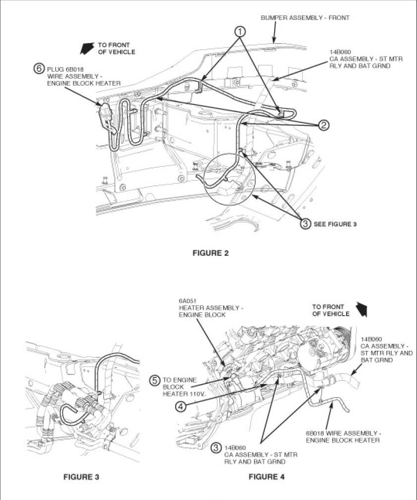

as long as it looks like this (i dont think we use the locking nut/ring) -->
