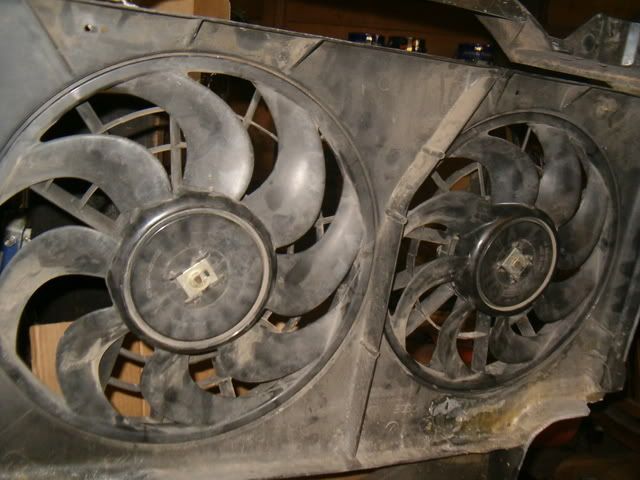

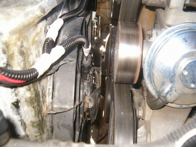

Anyone with some simple fab skills may wanna try the set up I came up with or use mine as a guide to customize your specific needs;tu
They work! electric fans article
couple pics....click the linky for the entire job and results :D

Jesse, negetive on having to "buy" two smaller fans......the factory Windstar set up has one motor that IMVHO protrudes too close to the vacum pulley and requires "re-clocking" by drilling new holes for the fasteners. As far as the the smaller motors being from a Taurus/Windstar ---yes the flat motor is stock to them.....see pic {this pic is of someone elses result that I used as a base for mine.}
What I suggested in my article was to purchase a second shroud assy from the bone yard....this will give you the second,flatter motor and cover AND a second shroud if you flub up while adapting the area where the motor mounts and another fan if you flub the tabs when grinding them down :D
I was able to get both units from the local u-pullit for under $100.
