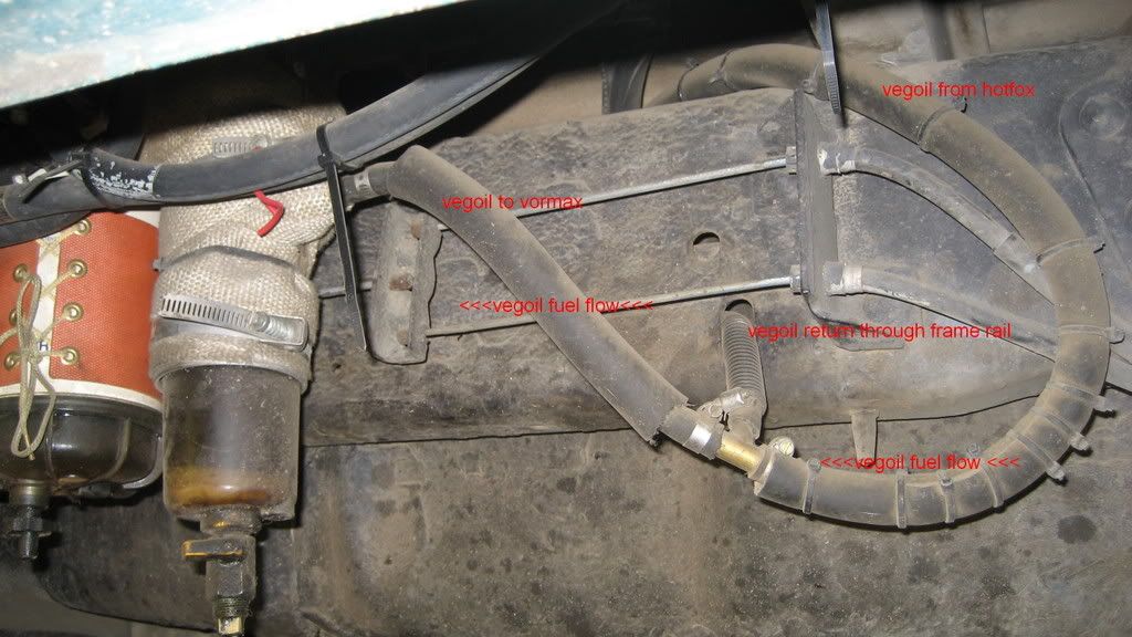

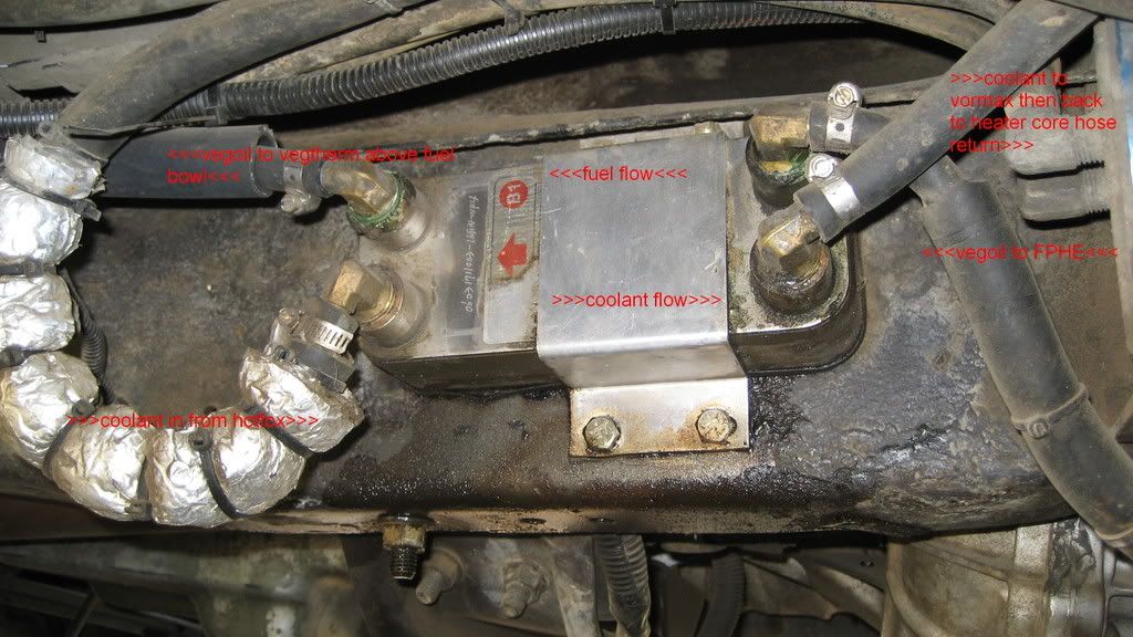

Do these help? I'm a bit embarrassed at the grime on my FPHE. I have a slow drip at top right fuel in. I need to fix it. :D The teflon paste will be replaced with permatex. That's a 12v pad heater on my Vormax for max heat on the filter for better fuel flow. So each heater core hose has a tee. Hot out heater core hose comes from the head then through tee to hotfox to FPHE to Vormax and back through return hose to return tee.

So after the Pollak valve (which was installed in the same location as the removed OEM switch valve) are the two thin steel lines that run up to engine. I bypassed the steel supply line because it's not insulated. So at the FPHE fuel out I connected a very long length of J30R9 that runs forward then up driver's fender and comes up near the brake booster. It is fed through the engine lift loop then around the bend to the vegtherm, temp sender, post filter, ball valve then right down to fuel in at fuel pump. I removed the stock hose (from the steel supply line to fuel pump) and pushed the supply line out of the way for my J30R9 and hose clamp to fuel pump in. I slid a 5 foot length of heater core hose over the fuel line and pushed it rearward. This is a protective sleeve for safety and abrasion. This protective hose begins at FPHE fuel out and ends under my Tymar but the fuel hose continues as described above. The steel return line I left intact and the Pollak return fuel port is looped through the frame rail in above post and goes back to Vormax vegoil in.

How hot is are your plastic fittings rated? The FPHE gets to almost 200*F. If you look closely at my FPHE the top two brass fittings have a green slime and the bottom two don't. WVO and copper don't mix so the green is the oxidized copper in the brass. The bottom two are the coolant and are fine with brass. I'm serious thinking of upgrading some brass fittings to stainless steel especially those. Cheap SS fittings! . Do it right the first time.
