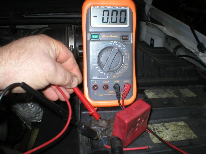

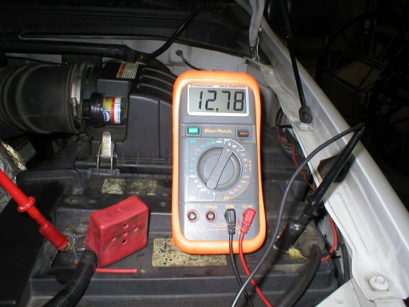

Voltage drop testing
ok here we go..
this is open circuit voltage
what we want to find, is how much voltage is LOST across a connection or component..
so let's check the voltage across the positive cable between the two batteries..
we're going to check between here
and here
we lost .01 v on the cable..
not bad
let's check across the connection and see if we lost it there..
nope...
connection is good.. no loss.
