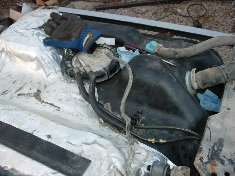

Well the fill point on the tank faces the side and is above the frame level. If you run it to the plate it will be going up hill.

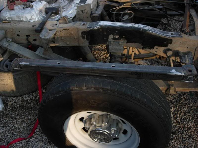

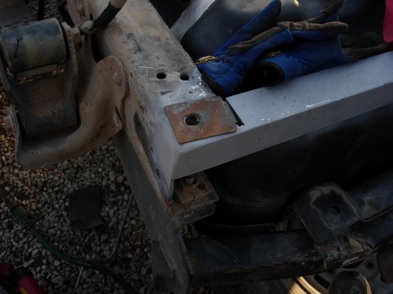

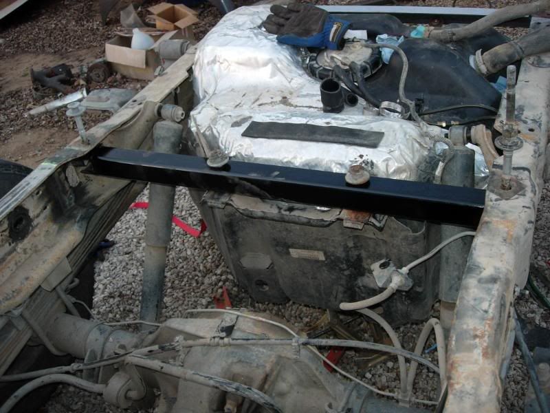

I pulled the Xmember/spare tire mount tonight and did a loose test fit. Fits like it was made to go there. I will weld up a front and rear cross member tomorrow to hold the tank and give more support to the chassis.The more I look at the hole where the tail light gores I think that is where the filler will be. SOme fab work yes , but it will be unique.

Ok ladies, I picked up the skid plate for the tank today. I will get plenty of pics tomorrow of the install. I will have to wait for the filler neck pics until the bed is back from paint. So far this is a pretty easy mod and the benefits will things like better weight balance and room for my airtanks and Horns.:sly
