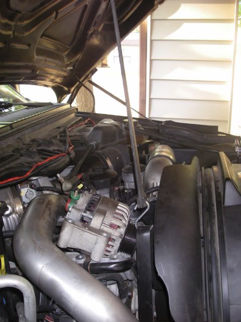

I am going to attempt to do this with out taking the fan shroud off. I think the belt will pull the idler pulley up if I am lucky. I have the old alternator sitting in the position I am going to try when I get the new one. I am using a bungee cord to make sure the belt doesn't come off any pulleys (see the picture). It fell off once and took me and two other guys 15 minutes to put it back on. If it falls off again I am going to just take out the whole fan shroud to do the job. If I have to do this, I will take pictures step by step because I don't think anyone has posted it yet (correct me if I am wrong because I was looking for it) The score marks in the shroud are pretty easy to get at, so I don,t think it will be to much of a job, should cut fine with the dremel, if not the 3 inch cut-off wheel is my second favorite tool next to a 5 pound hammer.

Well it all went back together without a problem. Didn't have to take apart the shroud or even use the ratchet strap trick. I looked at using a ratchet strap at the beginning and there is no way I was going to get my hand anywhere near the idler pulley! you guys that have used the ratchet strap must be a contortionist. (I am sure there is a easier way than I was looking at it but I couldn't see it.:dunno
If you look at the original picture at the beginning, thats basically what I did to get the belt on. I set the alternator under the belt in its slack position with the new alternator at about a 45 degree angle. I used the the alternator to lever it up along with pulling on the belt with my left hand. It was surprisingly easy to move the idler pulley by pulling up on the belt, just not easy enough to mount the alternator then pop the belt on. once you get the alternator back to the flat position, have a bolt handy and get it started and you are all set. i used a rubber mallet to move the alternator around a little once the first bolt is caught. Would have been a lot easier with two people but I did it myself.
This method works. It saves alot of time (and saved my *****). Got my alternator changed in the dark with only a couple tools, bungi cord, and a flashlight by myself. Total replacement time was about 45 minutes (not counting the ride to the parts house).
