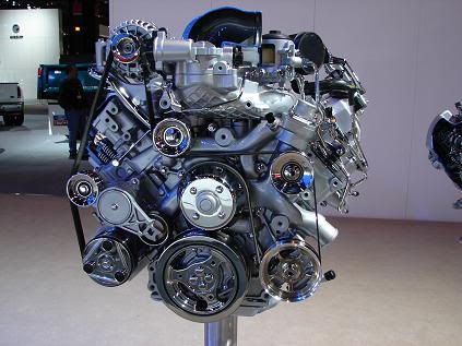

I have heard of this technique before as well, It looks to be an extremely tight fit to get to the idler pulley I found this picture and it all made sense though.

The key is to use the proper bungee cord length combined with the proper tensile strength. If the length is to long or the tensile strength to high, whammo, right on the noggin. :doh: There is a pretty scientific technique that I developed that involves trying all the bungee cords in your tool box until you find one that holds the belt up and wont slam the hood. :innocent If you look at the picture in my first post you will see the delicate balance between bungee length and bungee tensile strength.

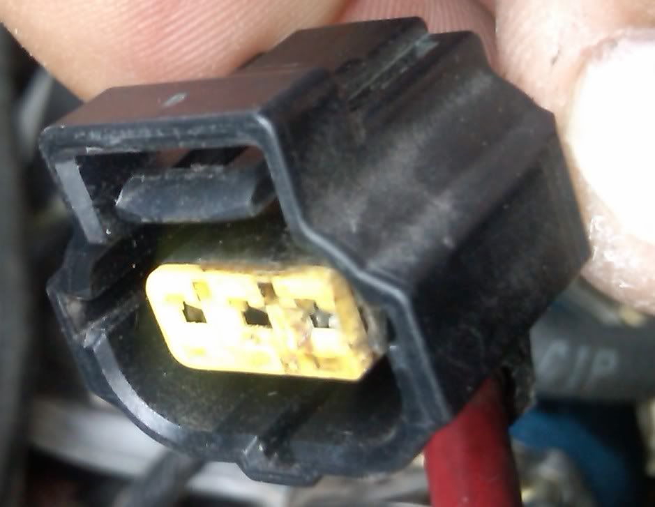

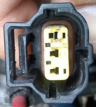

Pulled it this morning. I noticed that the regulator harness/plug looked like one of the 2 conductors had gotten hot at some point. I was just a little discolored around the one socket. Not melted. The little socket looks like it may have a bit of corrosion. I'm thinking that the corrosion created some resistance which created some heat. Heck... This could be my problem instead of the alternator itself. So, I'm getting a replacement alternator and a new plug from XL. That little bugger is $30, but I don;t want to have any doubts.
Take a look at the pics and tell me what y'all think. Any ideas on what might have caused the heat/discoloration besides maybe a little corrosion?
