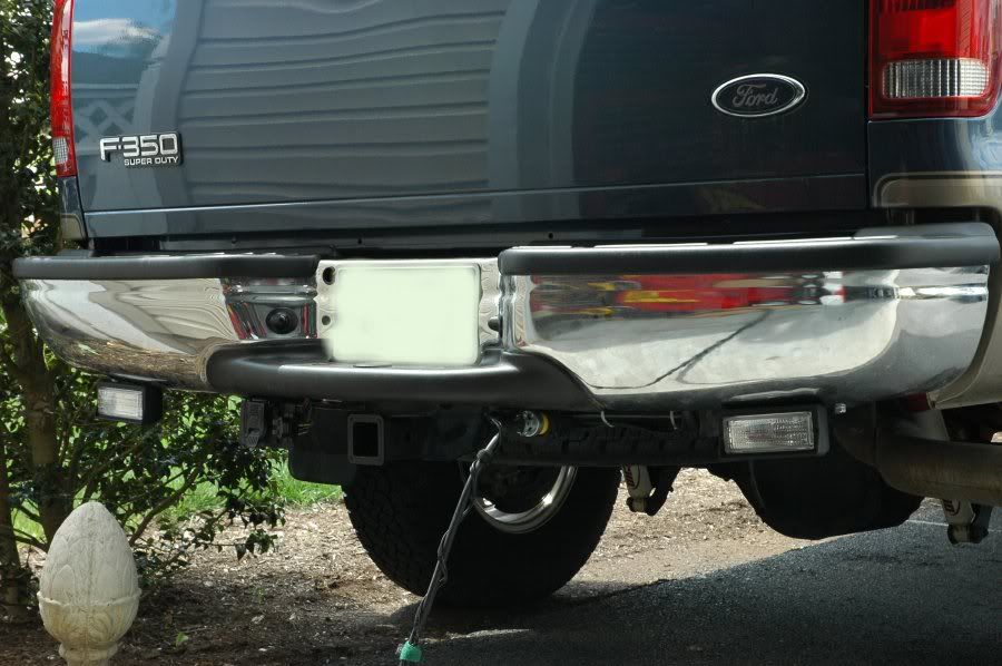

Im a bit surprised you dont have some halogen reverse lights
mounted under your bumper...theyre very handy when connecting
or disconnecting the trailer @ night....not to mention when backing
UP these city block long, tinted window beasts !
you can see the KC reverse lights that i installed in this photo -->
you can buy 'em just about anywhere
2x6 Back Up / Flood Lights<br>System # 517
or use their wiring diagram to connect some better or cheaper ones....
http://www.kchilites.com/faq/instructions/517_backup.pdf

That is a nice setup you have. I can see where the backup lights would be a real plus hooking up at night. That will use up two of our 4 upfitter switches. One for the backup lights and one for the inverter.
