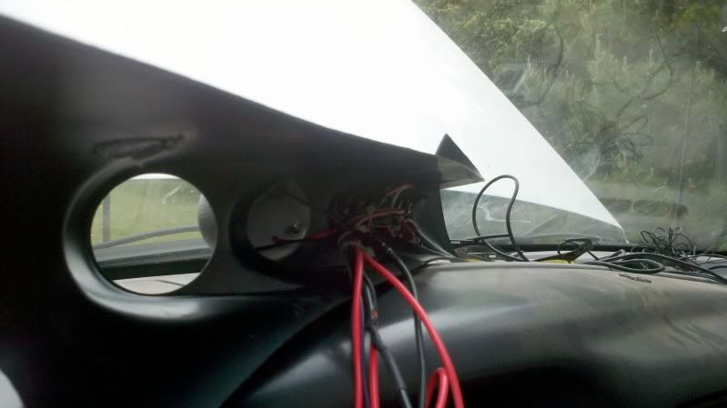

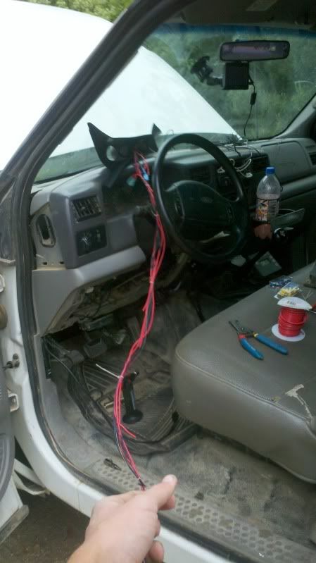

Got pretty much everything finally intalled except to tap the filler plug for the trans for the trans temp. soldered and heat shrunk all the joints.
Alot of wires. Just wondering what I should be shooting for for fuel pressure. I is a little less than 60 on the gauge.
Ended up just screwing it to the pillar.
70 psi fuel pressure @ idle is the target. 65~68 cruise'n is good.
Coupla #4 mini washers under the FPR spring will get ya there. ;)
