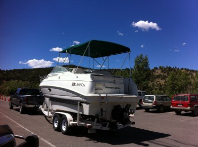

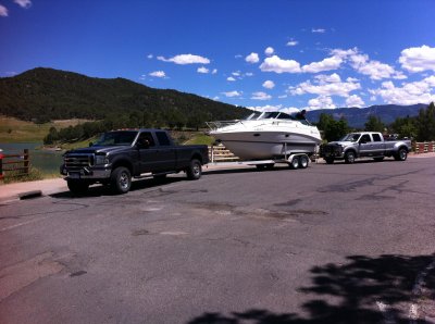

New tow toy from this last summer. About 10-11K fueled up. Tows great. About double the weight of the one it replaced.

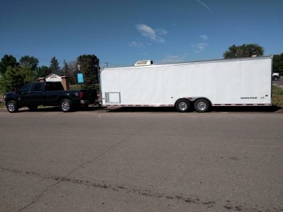

Sold the 07 F250 with 113k on the clock, running like a champ and bought a new 2015 F250 Lariat with all the "creature" features"
Hooked up the car hauler to see how it towed.
The trailer with race car, golf cart, and other stuff is just 10k.
We're very impressed with not only the power but the handling as well.
