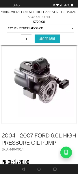

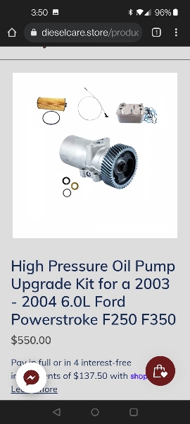

Sounds good. If it comes to that it will habe to be my winter project working between storms. Doing it myself will save a ton and then I can afford an upgraded HPOP.
I was getting confused seeing the two different pump for an 2004 6.0L.
Below pics are the 2 different HPOP's that claim to be for the 2004 - 6.0L Diesel. Are they really interchangeable? The top housing in the change out videos that I watched look totally different and connect differently, but go in the same location under the Turbo at the back of the motor.
Or am I totally off base and one of the listings are wrong?

That advertisement is wrong. That first pump (SKU:440-0014) will not fit in ANY 2004 model year. It is an error that sadly gets perpetuated by a lot of parts suppliers. That style pump is ONLY 2005 and up. If you try to fit that pump in an 04 you will be VERY sorry.

That advertisement is wrong. That first pump will not fit in ANY 2004 model year. It is an error that sadly gets perpetuated by a lot of parts suppliers. That style pump is ONLY 2005 and up. If you try to fit that pump in an 04 you will be VERY sorry.
Okay. That is why I would never jump the gun and buy something without knowing what I am replacing. Thanks for the confirmation.
