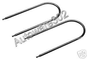

Jamie,the U tools should slide in and both "click" at that point place outward pressure on each U toll while pulling the stereo outward. The stereo contacting edges might be sticky from dried coffee,soda,juice,etc and in that case a light shot of windex/glass cleaner around the edges might be enough to break the sticky surfaces loose enough to draw the stereo out.:sweet
Give er a shot and lemme know how it goes.

I think I may have the wrong tools. I just looked online at the one at Wally world and the tips look a bit different than the ones I got at Pep Boys. The one from that says Pep Boys is the one I have. It says its for Fords. Am I supposed to have the one from Wal Mart?

I have used the Pep Boys ones and they work on my truck with the stock radio.
Dave
Thats wierd. I've tried it on my truck and my Dads truck, both with stock radios, and it doesn't work on either one. I've tried putting pressure to the outside ,inside,top, and bottom and all it does is just slip right back out.
I can't push them in any further either. I'm going to make a stop at Wal Mart and see if theirs does any better.

Push them in until they just "click" into the taps. Any further won't help. I don't think it is a tool problem, maybe an operator error???

Well, I got the ones from Wal Mart and they worked like a charm that sucker slid out so easy I almost dropped it. Sat is in and crystal clear now. Lovin it. Thanks for all the responses guys.:sweet
