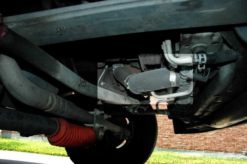

youll also wanna keep an eye on the lower radiator hose...run your
hand all over it, make sure its not getting rubbed by the steering
arm(s)...in earlier model years they put a nylon/web sox over the hose
TRYING to reduce the friction...it didnt work on my truck & i wound
up w/ a rub/gash in the hose..you might not have the problem...
but its worth checking and keeping an eye on.
I cut the old hose and wrapped it around the new/replacement for
a little added protection.
