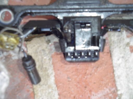

running extremely rough
bigfootpsd96
Feb 18, 2006
41
Norfolk,Va
found the problem :D
pics kinda blurry...but i think someone ordered an extra crispy conector
now i just need a new valve cover and injector harness :doh:

a valve cover, injector harness, 8 new gp's and 200 bucks and my rig is back on the road. man i think its been on 7 cyl for a long time, even before i bought. it idles like 10x smoother than it did and its also quieter at idle. i also noticed that when im driving my egts are alot lower too. im happy as heck.:D :D :D :burnit
