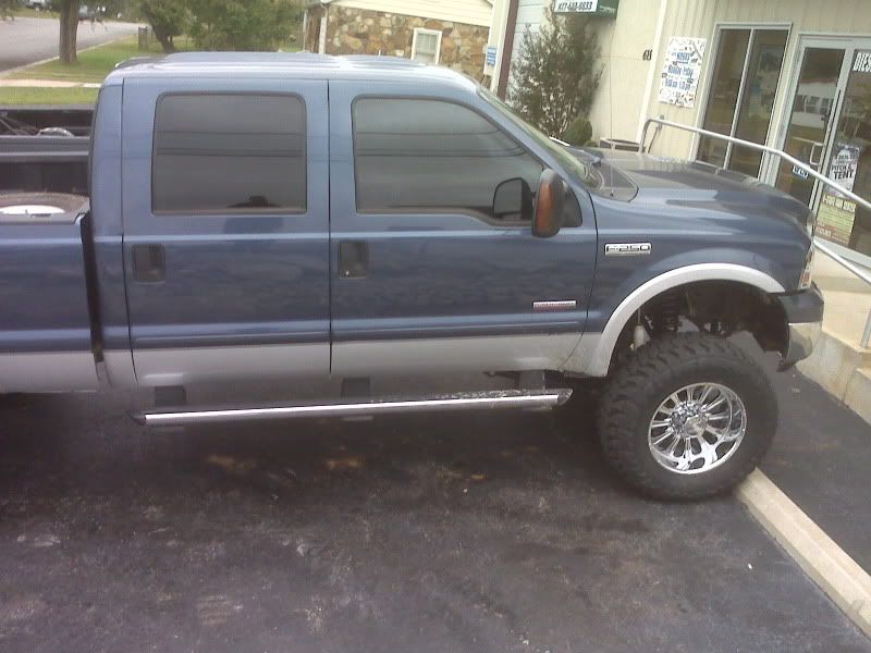

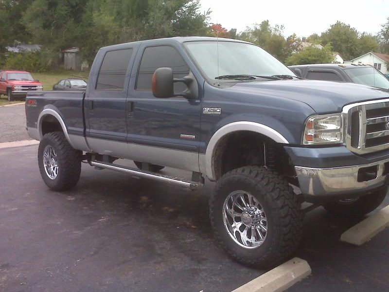

I sold my dually here three weeks ago, and found this truck for the right deal, so I snagged it last week.
It's already been checked over underneath, diffs serviced, oil/filter changed, etc. It also received new shoes and has a slew of other parts on their way right now! But, I have a cold start issue. If I don't plug the truck in (even at 50 degrees), it chokes and sputters and blows smoke like a mad man til its warm.
