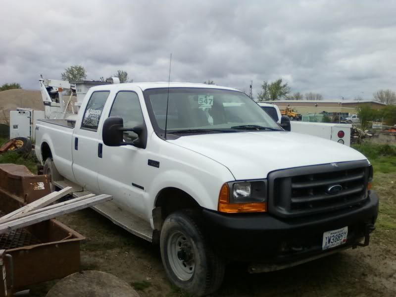

Here are the headlights and grill
By the way here it is now
