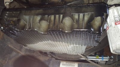

Oct 6, 2016 #11 02Oilburner SDD Power Hungry Joined Dec 20, 2007 Messages 596 Reaction score 10 Location Raleigh, NC Looks like I need a new oil pan also! Had the oil changed and then drove on 2400 mile round trip before I noticed the leak. Pisses me off! No leaks at all now I have to clean all this up.

Oct 7, 2016 #12 02Oilburner SDD Power Hungry Joined Dec 20, 2007 Messages 596 Reaction score 10 Location Raleigh, NC I meant to ask where to get a good metal pan reeplacement. Thanks guys!
Feb 11, 2018 #13 J jsum24 SDD Junior Member Joined Oct 23, 2017 Messages 21 Reaction score 2 Location FL. Got mine from Ford. Is yours aluminum? My old stripped one was.
Mar 18, 2018 #14 carbonation SDD Junior Member Joined Mar 17, 2018 Messages 46 Reaction score 14 Location Midwest The late 12 and up steel pan fixes this problem straight away. There are (some) aftermarket aluminum pans that increase capacity and have cooling fins as well. Extra capacity is always nice, (solution to pollution is dilution). My BIL's 11 drips as well. I tell him it's not a leak, it's marking it's territory! https://www.stage3motorsports.com/MAG-F67LDiesel-2011-2017-F250-F350-6.7L-Engine-Oil-Pan.html https://www.strictlydiesel.com/p-3643-driven-diesel-67l-powerstroke-oil-pan.aspx https://www.dieselworldmag.com/ford/stop-the-drip-early-ford-6-7l-oil-pan-upgrade/ https://parts.lakelandford.com/p/Fo...and-Drain-Plug-Gasket/52213433/BC3Z6695B.html Last edited: Mar 18, 2018
