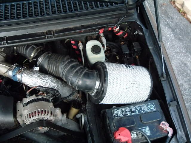

I have used this "Tymar" style intake for about 4 months now and love it. It is very affordable ( about $100 ) and you can do it yourself for less if you can find some 4" pipe. It is very noisy:thumbs but if I wanted a quiet truck I would be driving a gasser. From what I have noticed, most people have either Tymar, AIS, or the AFE. Just depends on how much you want to spend:sweet

i also run the Tymar stlye filter.all mine is, is the filter slipped over the intake boot, and a piece of 4'' long 4'' dia. exhaust pipe that replaces the plastic CCV connector. it's still there in the pics.
i also recommend the ZooDad mod too.

Great pics there 2001stroke and Kris :cool: :cool:
