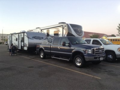

We left for our vacation and headed to Grand Canyon from San Diego. I love this truck, It didn't have any issue pulling my trailer with full of water and other stuff. Went up to Barstow and Needles with no issue going up the grade. So far, I love this truck.

Looks great! If you pulled everyday you might want to look into Air Bags for the rear suspension. You can air them up, when you are pulling, and they will level your truck. ;tu
