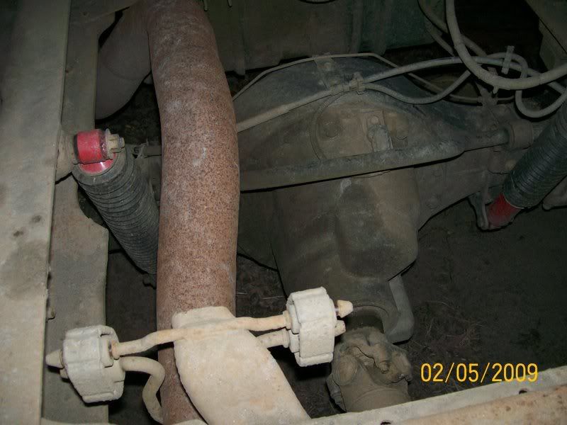

My truck has the HD 6 speed and 4.88's in the massive rear end. Great for pulling and hauling.
I'm wondering if going to a 5 speed or if there might be another gear set available for the huge rear end. Also anyone know what rear the 550's came with that might help me find a new ring and pinion.
Reason for this question is the truck might see some highway use. The motor is screaming past 60mph and shifting 6 times by 45 gets annoying in traffic.
if more info is needed i still have the window sticker.

Dana/Spicer part numbers for the R&P set
3.91 Ratio Ring & Pinion Set: 360KG105-X
4.10 Ratio Ring & Pinion Set: 360KG106-X
