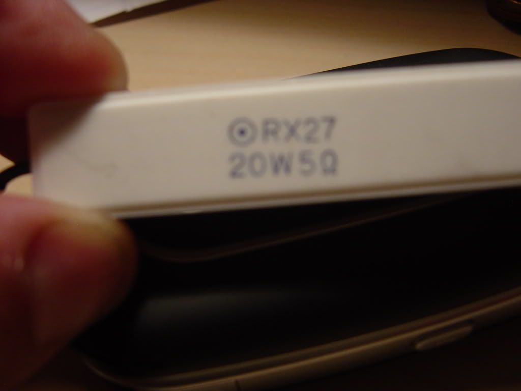

ok, you need to go to radio shack or any other electronic supply shop and get 2 resistors like the one in the pics, put these in instead of the bulbs under the cab.....and your pcm is tricked.....oh and guys if your not going to help the guy, don't trash his idea.....

Like has already been said, what is gained by installing the resisters. It will add the current that is saved by using the LEDs. They will draw .6 amps @ 12 volts and get hot. Other than the LEDs may last longer, nothing will be gained by doing this. If they really are needed to make the tranny shift correctly, stay with the regular bulbs.

dude the resistors will do what you need, with the bulbs you want to install you have to worry about them burning out, not with the resistors... yes they will get warm but thats what they are made to do....
