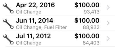

Bo while we got you on here I have a question about your Frantz Filter Bypass System. I purchased my 1996 7.3 Powestroke brand new. 20 years later she has a whopping 94K on the odometer. That figures out to 4,700 miles a year but in the early days she probably got more and now probably around 3,000 a year. I change the oil with Mobil 1 synthetic 5w-40 turbo diesel truck once a year. I hear the big advantage with bypass filtration is extended intervals but I am already a year between changes which isn't really recommended. To go 30K I would be looking at 10 years. Would there be much advantage in the extra filtration when my oil gets dropped after only 3-5k anyway?
Edit: I just checked my records and it looks as though I have only been changing the powerstroke every two years but still only around 4,000 miles. That's probably not good.
LOL, you don't drive a lot do you....
Actually I do a little bit just not all the miles are in the OBS. I have a 2015 Superduty that I purchased 19 months ago that has 10,000 on it, that's over 500 a month. I have a 1994 Explorer with 180,000 on the clock that I drive sometimes though it hasn't left the driveway in a couple months. Add in the 400 miles a month the OBS has averaged over the last 20 years and I become average. To top it off I also put about 120,000 miles a year on a peterbilt. In summary I am thinking about all I do is drive.
