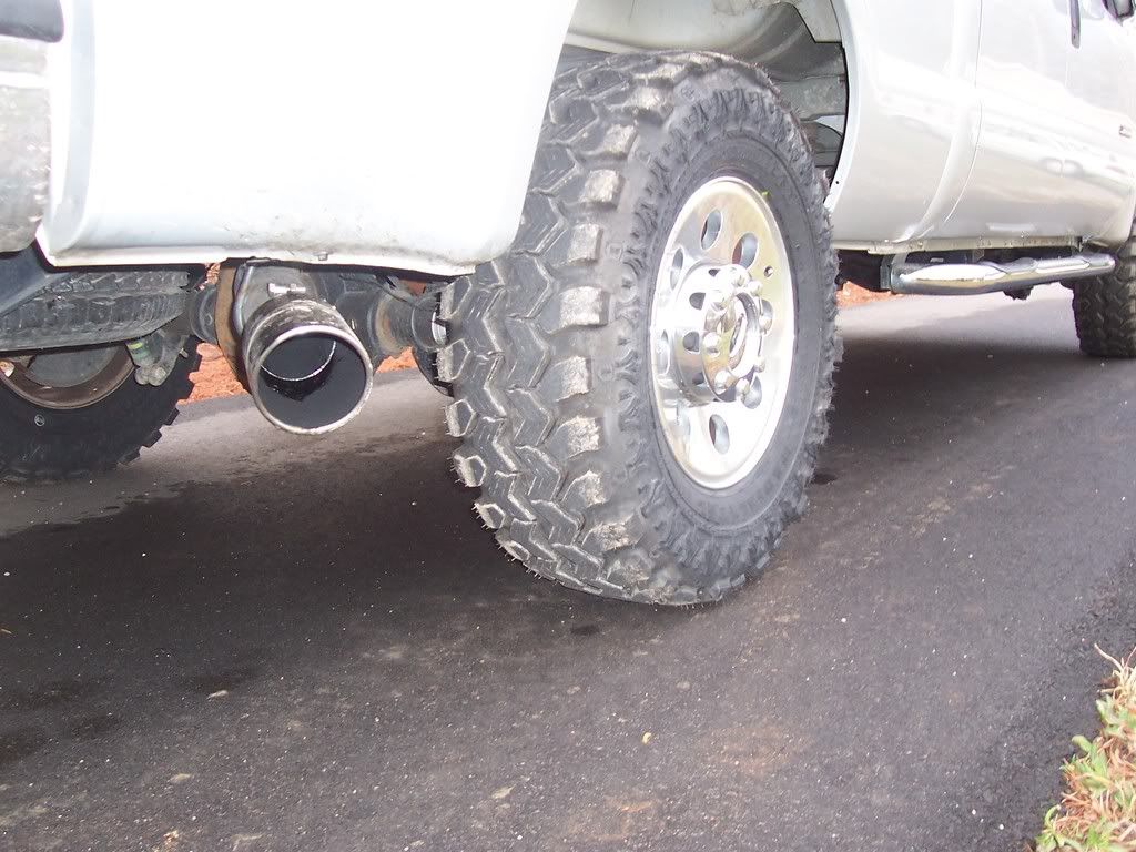

Truck is DIRTY! Needs a bath. But anyhow, here they are, what ya think?

They look good, but judging by the dried dirt on the treads, I think you might have them a little over inflated.
They sure look aggresive, they'll proabably get you anywhere you need to be.

Thanks. I dont think they are over inflated. The dried dirt is on the lug, that actually angles downward. I have them at 60psi all around.
I know the 17x7.5'' wheels are not ideal for a 12.50 tire, but will work for the time being. I dont think they are over inflated. I have them at 60psi all around.
I have 12.50 rubber on stock wheels and to make them wear even I have to keep them down under 45 psi. When I load up the camper I can up them to 60 psi. The narrow wheel pulls the sidewalls in thus making the center of the tread bulge. Chalk them and I think you will find 60 psi is way too much on those wheels. Lower pressure makes for a better ride anyway.
Rig looks great with those meats :sweet

Tires looks good. Really aggressive looking. Do you get any road noice from the tires or is it still pretty quite

Yeah, the more I drive it, I do believe I need to drop the pressure. Ill play with it and see what works, trial and eerror.
As for the noise, yeah you can deffinatley hear them, but they are tolerable, atleast to me. They are alot quieter then say a regular swamper radial. ALOT quieter then my boggers that I have on on my Bronco LOL

Hey Silver, nice tires, looks good. I can see what your sayin where the dried mudd is it is angled. You would have to be pretty low on pressure to ride on that part of the lug

Nice, tires look awsome man.
