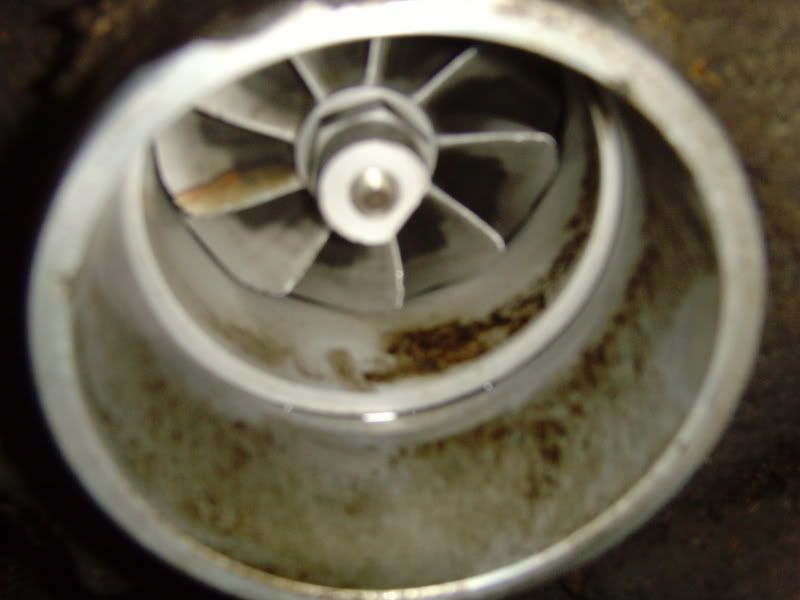

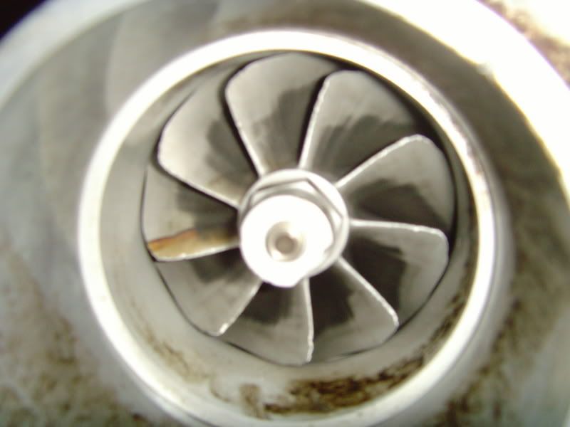

I took the hose off and took a couple pics of the wheel. It looks chipped to me but there's no play in it.
Thanks!
9,641
84
That turbine wheel has seen a fair amount of dirt and other junk. Get a new wheel, that one is shot. Why the rust?
