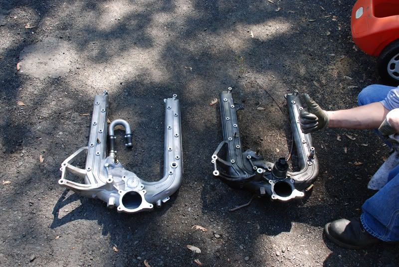

Notice the intake on the left is modified to delete the cooler and the valve. First Coast Diesel Performance sells them. They're a bit pricey, but a good solution to total elimination of the EGR cooler.
I haven't gotten that far yet. As of now, I've welded shut the egr flange on the up-pipe and replaced the egr valve with a stainless steel spool I bought off ebay for ~$50. So I have no exhaust getting in the backside and no intake air getting in the front side, but I still have coolant running through it.
