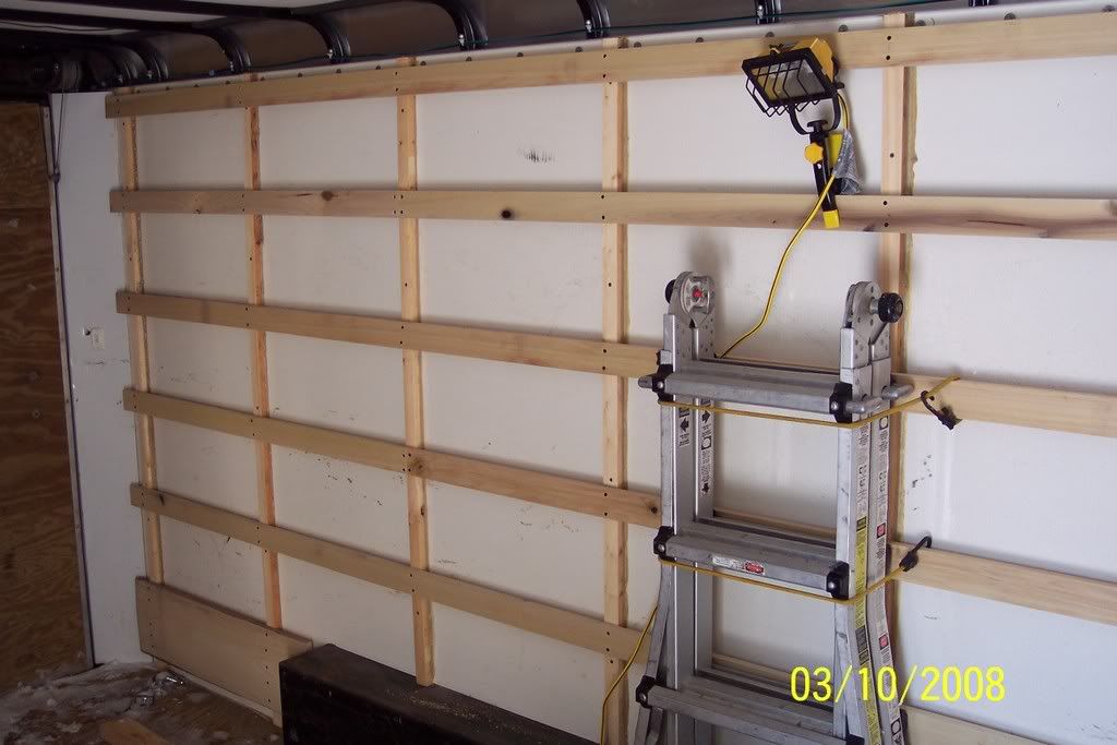

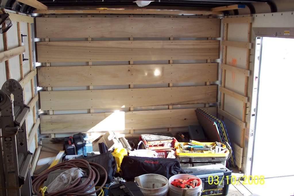

i ended up framing some racking inside to accept shelves and cabinets, and i'm going to make a fold-down workbench. the trailer walls are 1/2 inch plywwod with fiberglass and gelcoat on both sides. so i took a sander and roughed up the inside walls on my layout and then screwed and glued (PL Premuim polyurethane construction adhesive) some 1" thick rips of 2x to the walls and then screwed 3/4 x 2 1/2 poplar rips across them and 1x10 poplar on the front to allow for banging stuff against the front wall. i can now hook straps to the poplar, and run 110v electric behind it for lighting and outlets. so i will have a small moble shop.

Nice set-up. I wish I would have thought mine through more before I did it. Too busy now to take a week to rework the trailer. If you bolt any kind of racking to the floor?, Make sure the legs sit on a frame crossmember & if they don't ad steel support underneath the trailer. Also attach them to the walls to avoid the racks breaking free from the floor. Mine have caused the floor to dip between the cross members and have broken loose from the floor on bad roads. Your best off buildign your own racking the same way you lined the trailer, glued & screwed!!!! :sweet
