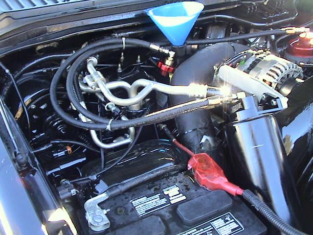

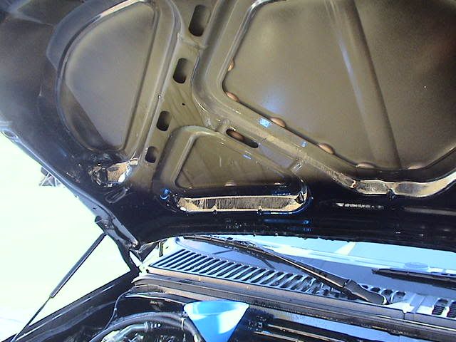

I've got the Amsoil BMK-11 bypass filter mounted on my X. I installed it on January 3rd and it has blown the rubber o-ring on top of the spin on canister 3 times since then, each time leaving me and the family stranded.
Here's a picture of the blown--or popped-- o-ring:
Oil on the hood (hood blanket is still draining in the garage from first blowout):
Oil all over the engine bay (taken at service station while refilling):
Needless to say, I'm unhappy with the bypass filter and need advice on fixing the problem. As I see it, I've got 3 choices:

Since the rubber o-ring is blowing out, I think that either the Amsoil system can't handle the oil pressure from the engine, or something in the filter assembly is clogged. If the inlet to the bypass were clogged, I'd think that the oil simply would not enter the bypass system. But since the o-ring is blowing out, I think the outlet from the filter is clogged causing too much pressure in the bypass filter element.

It sounds as if you have a faulty filter, the system is most likly fine. On the bottom of the filter is a spring and baffel, when the preasure gets to high, the baffel is supposed to open and allow the oil to free flow past the filter. If the Baffel is stuck or if the spring on the bottom of the filter is faulty it would cause the problem you describe. I would get a new filter, I suspect you would be OK after that.
