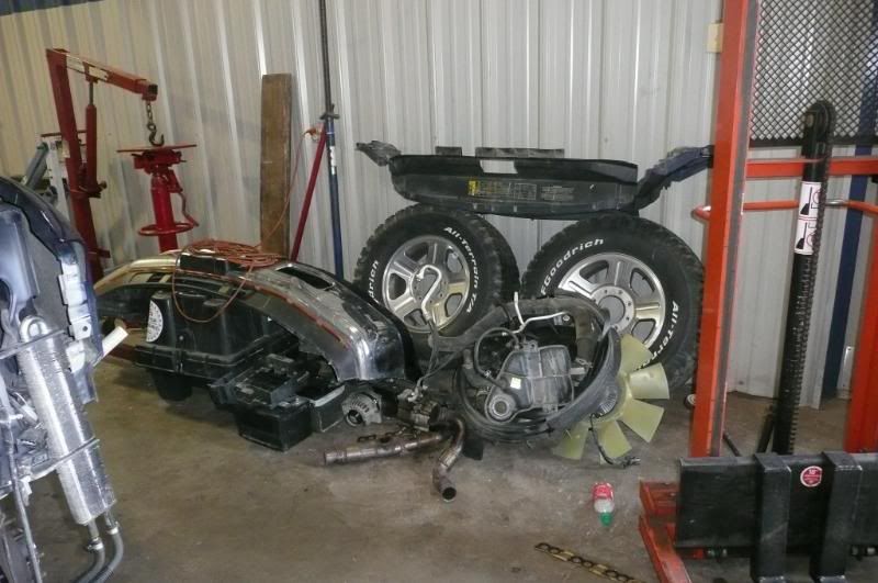

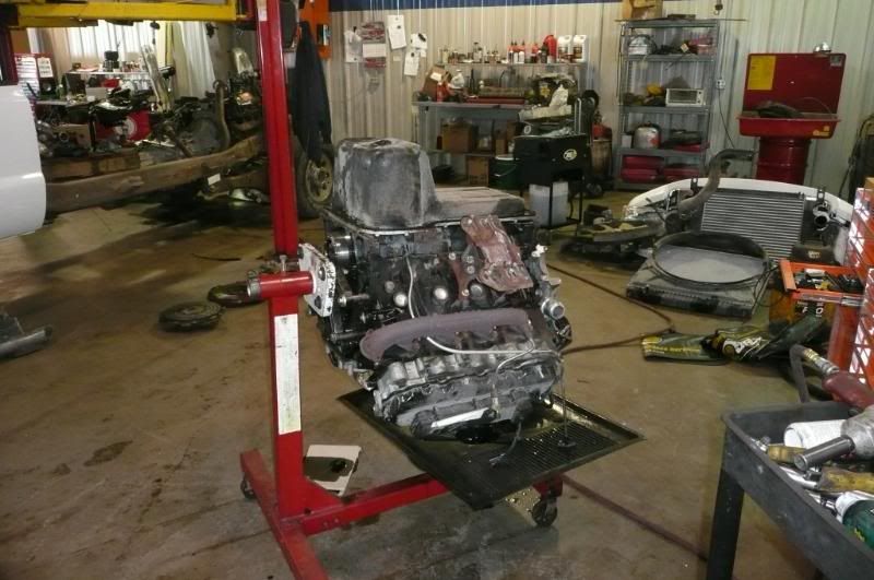

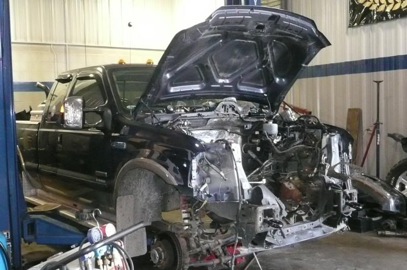

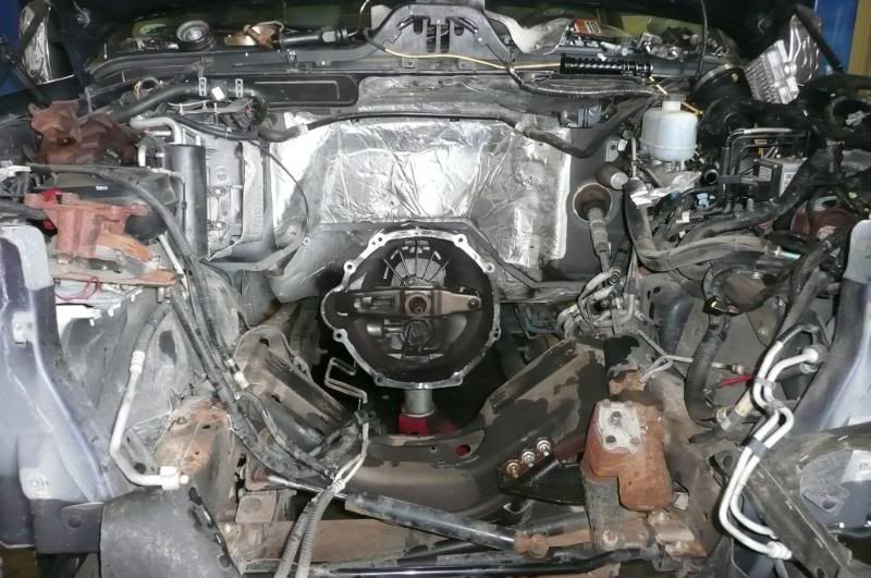

Dropped the truck off that morning, and by 5pm it looked like this!! Here are some pics...
Some of the parts along the wall, rest in the bed!!
