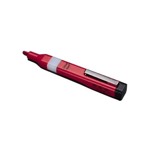

Like this one?

Those are meant for sticking in a 120V outlet Crumm, but the ones Ive used like them (Fluke) would light up next to a live wire.

Yep that be a "stupid" stick. Read what voltage they pick up, some will sense as low as 30 volts inductance and lie to you.

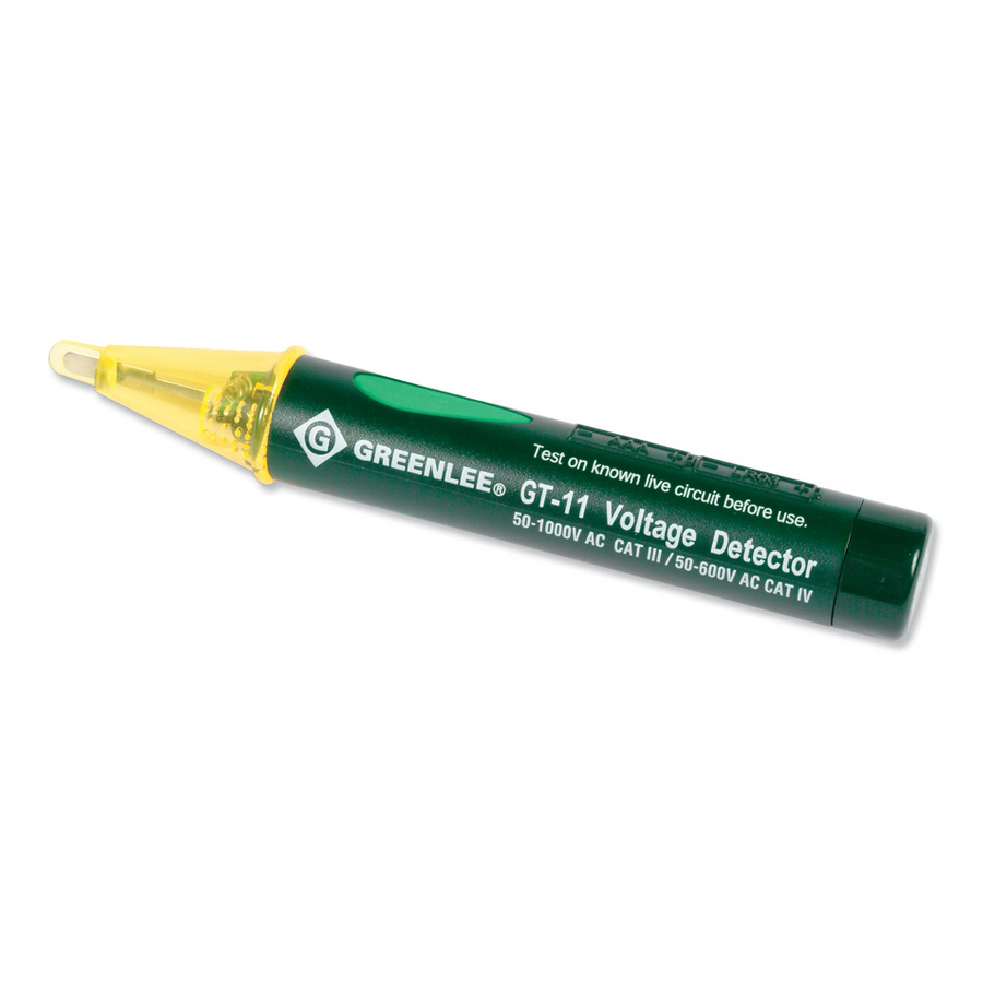

Crumm said:
Or this one.
Nothing quite like shopping for new tools :D
yep a Stupid STICK... but mine doesnt have to go in a socket... it tells me which conductor in the bundle is LIVE.... then I test with a VOM to be sure
