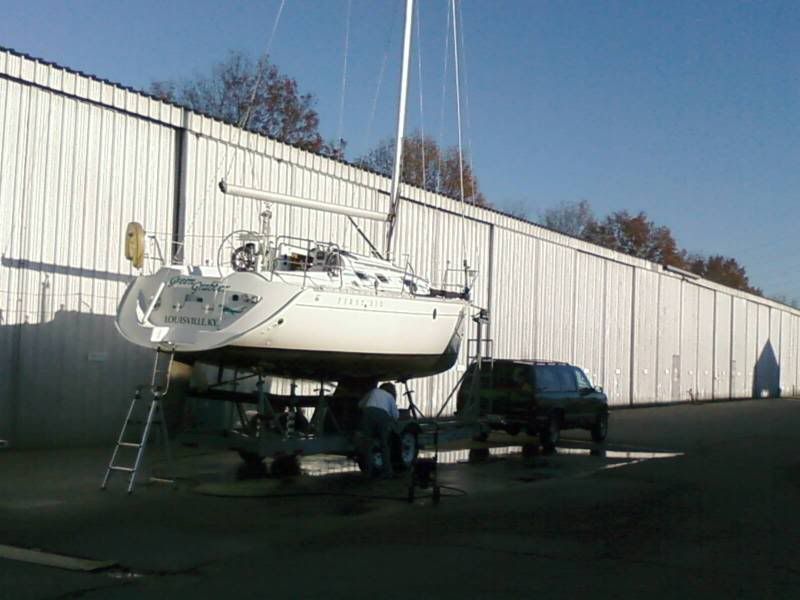

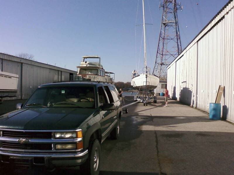

Your comment about having slipping on ramps leads me to say that you have adequate power but traction is the limiting factor so a gear swap would work and a locker wouldn't hurt you even with the current gearing. Depending on where you're launching many marinas will launch it for you for a small fee if the ramps are too slick for your rig. Keep in mind that when you're pulling the boat out of the water the hydraulic forces against the rear of the trailer and even the nose of the boat actually serve to unload the tongue weight. To battle any traction issues a tongue extension would be an ideal accessory, they are commonly used for launching and recovering sailboats with fixed keels or larger boats on shallow ramps. Here's a few pictures in use. This is 2 extensions in combo
