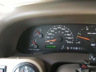

:sweet Congrats Rich !!!
Of all the places we went, all the trips we took 'cross country... my 2K turned 200K.. as I pulled in our driveway.. on my way home from work one day.
Strange how things like that happen.. and where ?

Thanks guys! I appreciate it.
For a "birthday" I got the rear springs re-arched (plus 1 new spring) yesterday. Sure rides with a new bounce.

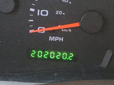

Weird odometer changeover...plus degreased the entire top, found a rubbed coolant line and replaced, washed it, got another scratch, looked over the rust forming in the rear wheel wells and under the driver side door, hope I don't have a leak at the oil/coolant heat exchanger or the lpop but something up there is wet...IMG_2508.jpg
