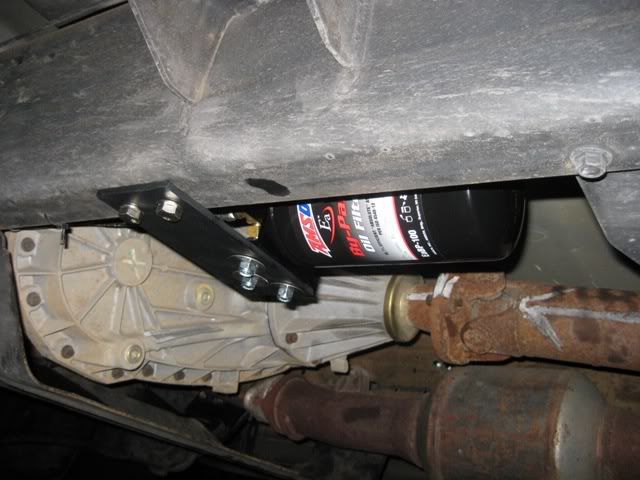

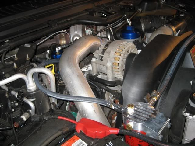

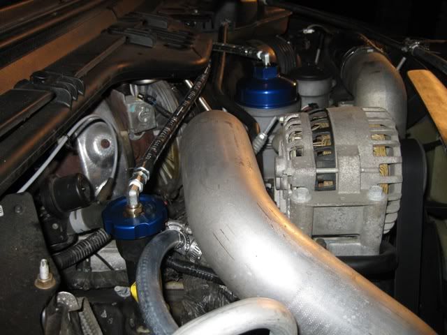

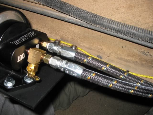

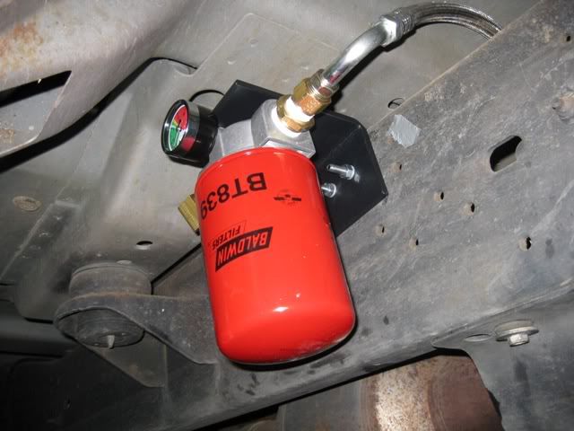

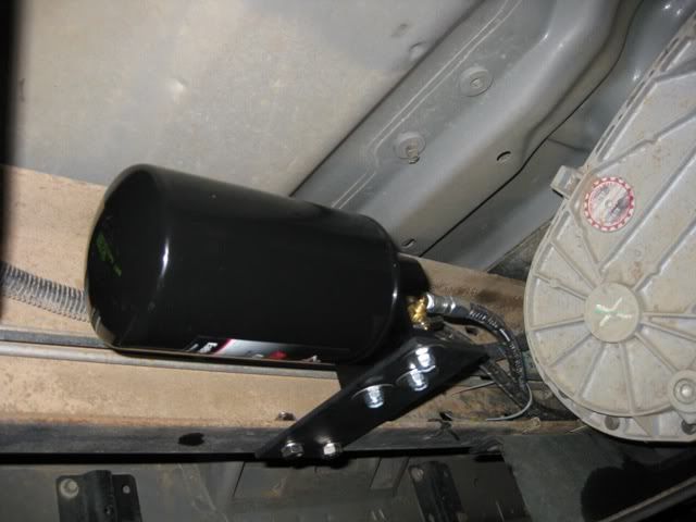

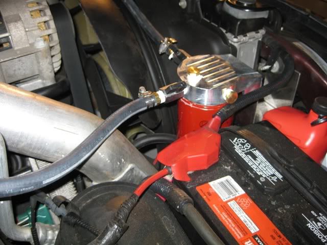

I got a little trigger happy with the mouse a couple of weeks ago and ended up with a coolant filter, transmission filter, and Amsoil bypass filter for my '06 F250. Got the last of it installed this afternoon. Check out the pics -
Engine bay with new billet filter and filler caps -
I had to put the bypass filter underneath the truck (driver side) because the coolant filter fills up the usual install spot off the alternator -
Tranny filter mounted to pasenger side frame rail -
Coolant filter -
Underhood shot -
