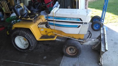

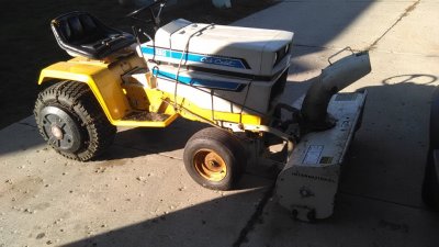

I have a set of 4 link on each tractor... and they work well for moving snow....

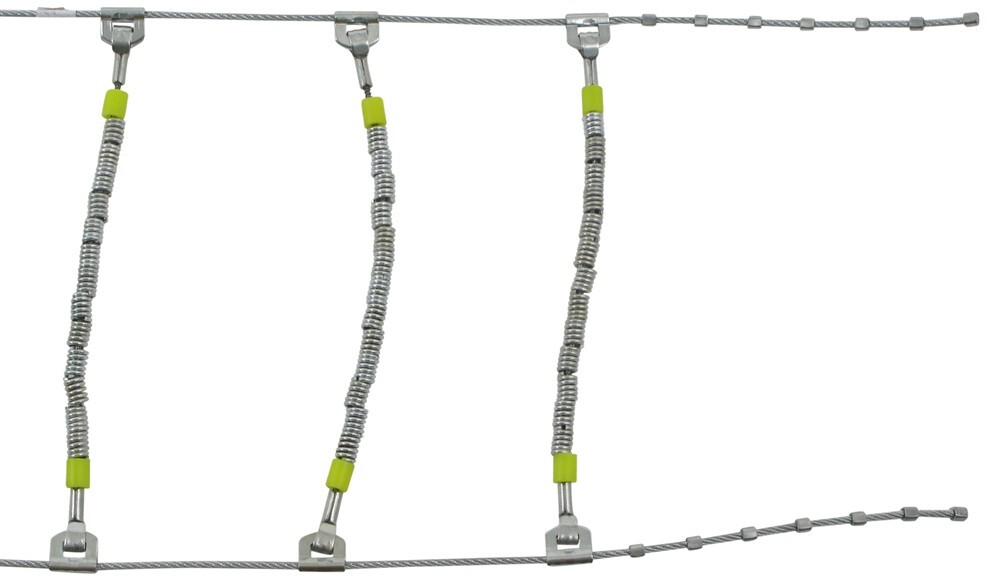

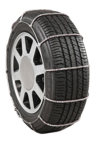

These are what I recommend against:

Watch your speed..... Yes, because it's slick if you are using chains, but, centrifugal force will pull the cross chains away from the tire, like a jump rope. So it's IMPERATIVE to install them correctly, and as tight as possible. For me, on the tractors, I deflate the tire, install the chains as snug as I can, and them re-inflate the tire to proper pressure ~12lbs. This makes them fairly tight and limits the "flail" the chains have. As you can see, I have very limited clearance, and it's not uncommon to see the rear fenders damaged due to chain flail

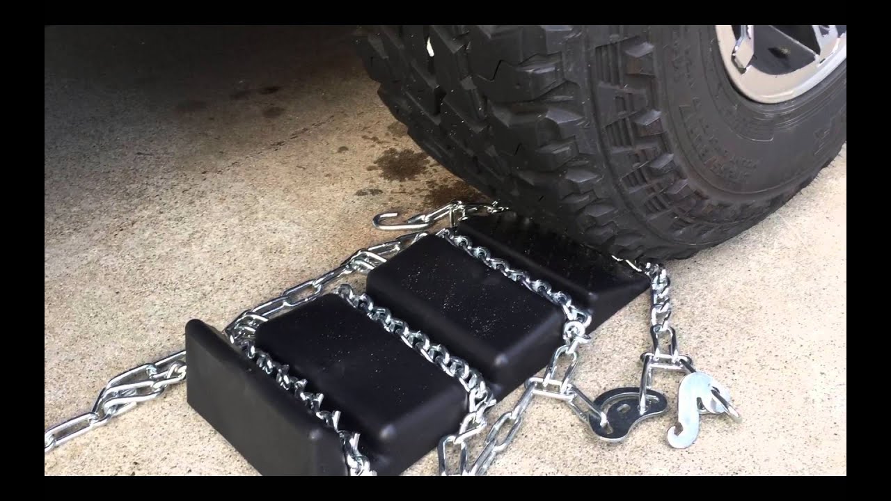

Practice installing them several times, at home in the driveway. Chains are not necessarily difficult to install, but I would not want to try installing them on the shoulder of a road. I've read of people make the comment on the Cub forum make the comment it only took me an hour to get the chains installed this time. Now, this is the second or third time of installing them. Myself on the other hand, I can take the decks off, install the blade, thrower and both sets of chains in an hour. But, I've done the swap/install probably a hundred times in the last 40 years. They make tire chain install ramp, that allows the chains to lay in grooves, so they can move, but are placed under the tire. I normally have the tire off the ground, and "roll" them onto the tire, but that is different getting ready for winter in October, vs on the side of the road.
