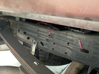

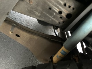

Looking at a 2015. I don’t know how to tell the difference between normal rust and “problem” rust. Anybody have any input on this:
Thanks in advance.
bcvickers
Dec 28, 2008
39
10
Minnesota
On the frame, that's nothing. I'd be looking closely at the cab pinch welds and up inside the rockers as well as the box u-channels.

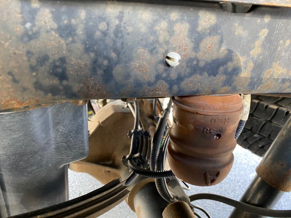

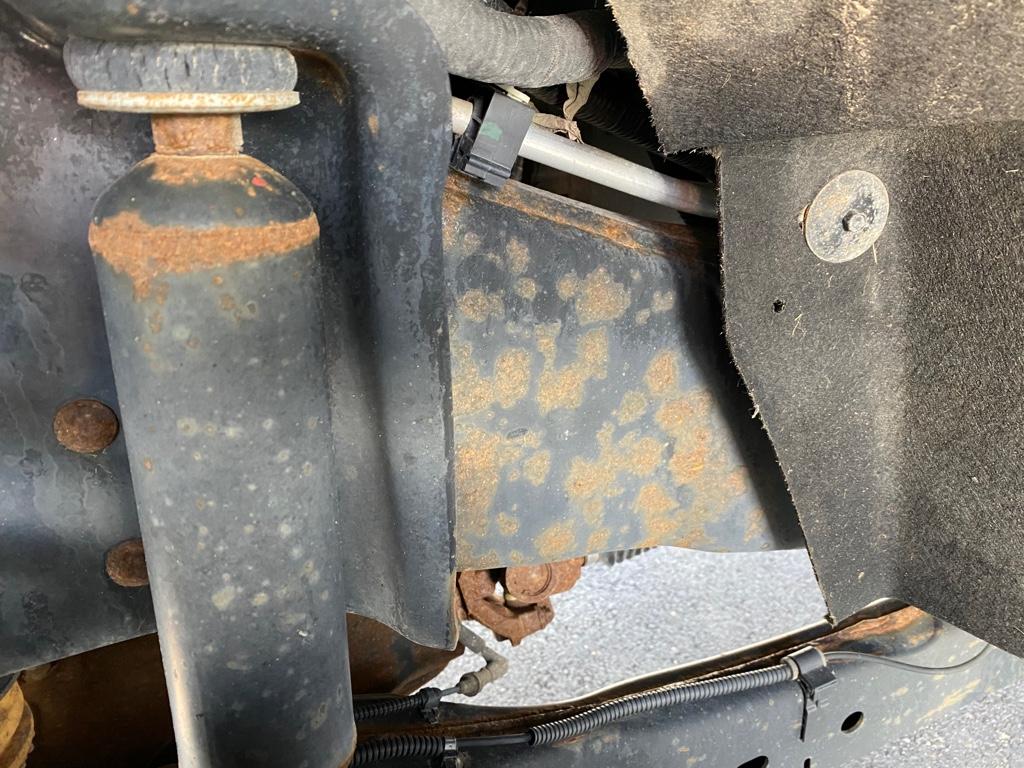

19D20E7C-97E2-40CC-AC21-137E0C9B0050.jpeg 9CDED8B8-FBDC-464F-B8F0-858B49998BF2.jpeg F0E09322-E55C-4EB8-8DEA-00D1EF06FD7A.jpeg It needs new shocks.... 0B397A25-876F-4A67-80E4-6927D2440DC8.jpeg
This is my 2005 250, Open the drivers and passenger doors and look up by the front bottom edge of the door frame and area ahead of door if you see Rust there
