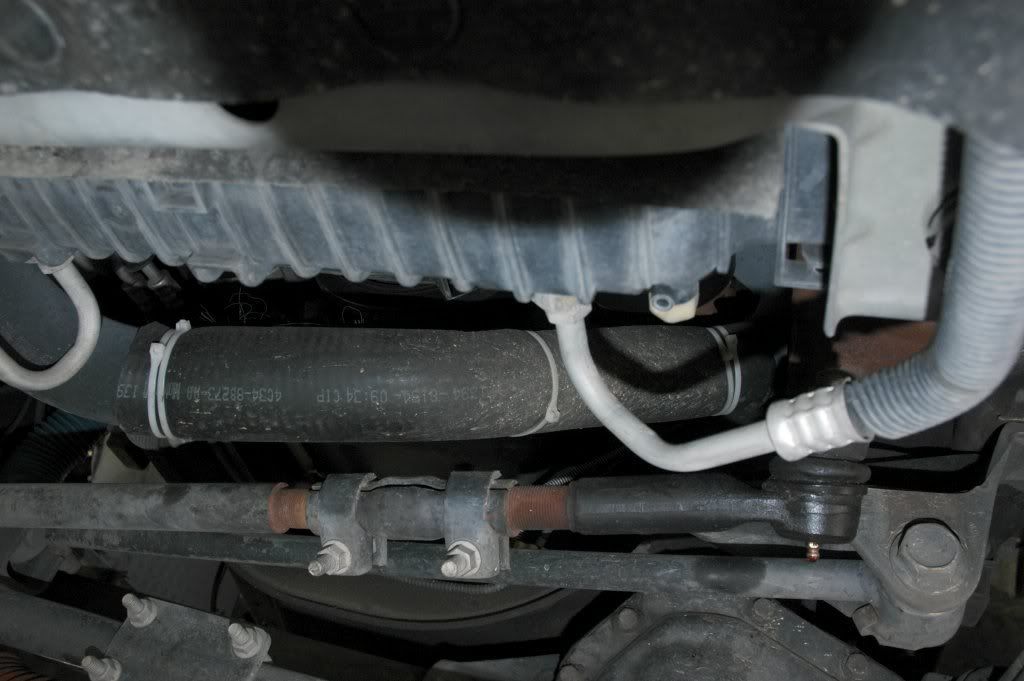

All i gotta say is wow. Have to remove the air filter and interooler pipe to get to the water pump end. Course prolly would have been alot easier if i wasn't using the only pair of channel locks that i had with me which are large enough for the largest filters. Hose was rubbing on the back of the steering box and rubbed a pinhole into it. Besides the one hose clamp the other difficulties was tryin to find a hose. Ended up having to have it shipped into o'reilly's. Oh well enough ranting.
i caught mine before it rubbed a hole in it...i used the old hose to wrap the new hose (give it a little more protection)
I didnt have to remove the intercooler tube (but then i wasnt using channel locks either ;)

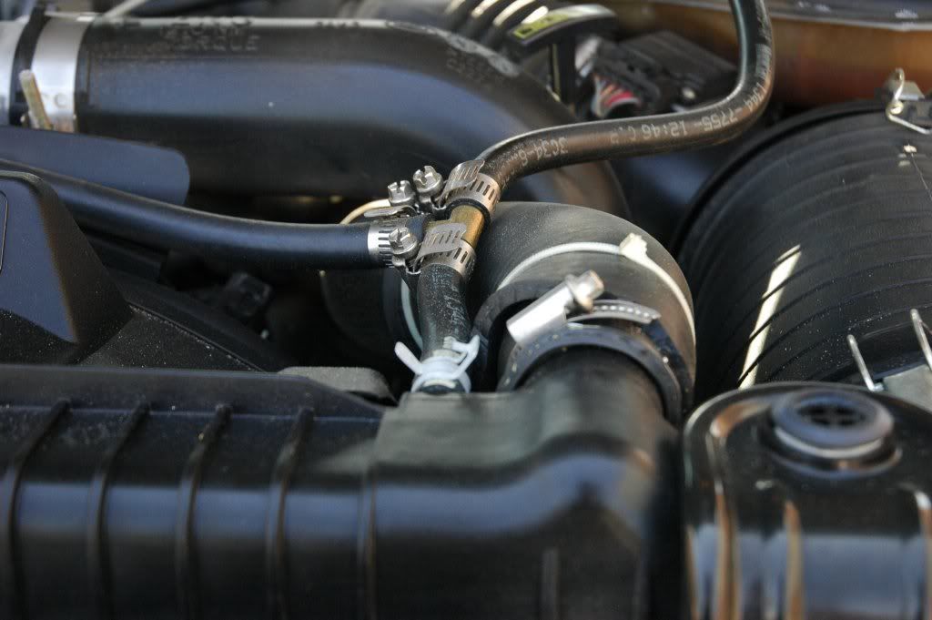

I saw some slight rubbing up top so i used what was left over of the old hose there too...the rubbing up
top is mostly cause of my coolant by pass filter "T".
Feb 22, 2007
967
georgetown texas
yeah i used a piece of flashing from work thats half inch thick. hope i never have to do it again and i'm pickin up one of the hose squeezer tools.
