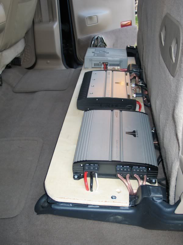

you can remove that tray system (youll need a T55-PLUS)...
look at the photos in my signature (links) youll see how i removed
the tray system and STILL dont have very much useable space...
the problem is that the floor is NOT flat...infact theres very little
contiguous area that is flat...and certainly not enough flat space
(under the tray systems) to mount even an AMP, much less a
sub/box.
any sub box that you consider will NEED volume...the jl stealth box
is probably the BEST solution (how ever like most things theres
a trade off (cash & usable seat)
--> test fitting of the 1/2 board (cut to fit) NO CARPET <YET> !
--> finished w/ CARPET <has since changed> the amps actually contact the seat bottom a little...at
the back of the seat/hinge. i can BARELY fit a 1/2 roll of FLATTENED paper towels under the board...between
the floor and the board...and the JACK / CRANK handle BARELY fits under the board (because there is almost
ZERO SPACE)

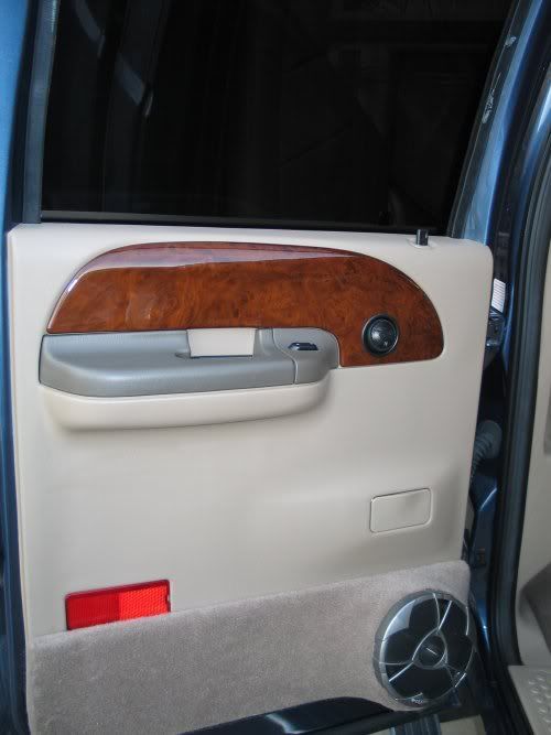

heres some ideas for mounting your speakers...(above photo you
can see speakers mounted on lower portion of the REAR door.
