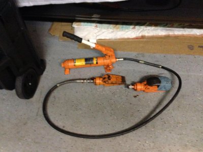

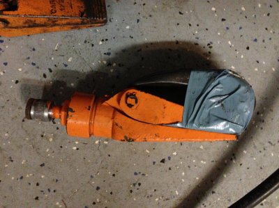

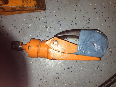

Just a quick thanks and update: stainless steel 3" Diamond Eye two piece downpipe has been installed. As suggested I made three relief cuts on the pinch seam. Also wanted to post a pic of a quick suggestion for those trying to make this clearance in the future: putting a rounded bodywork dolly onto the spreader makes for a nicer/easier way to use a hydraulic spreader/portapower to accomplish this goal. See pics: a little duct tape and I was all set :)
