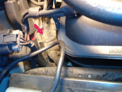

When they got in my 99.5 my lights on the dash quit working......then the battery went dead because the alternator wasn't charging. I tore the dash out and tested bulbs and circuits to no avail.
Traced/tested continuity on the power wire through the firewall into the wire harness, up to the front of the engine then I lost it as it went around the front of the motor past the alternator. As I scratched my head wondering why it was going that direction I started searching on the opposite fender well and found this. It was a small loop of wire plugged into a harness in what I assumed was the connection for a dual alternator set up. PIA getting to and re-soldering that wire but it fixed my problem.
Tbar
View attachment 13009View attachment 13010
