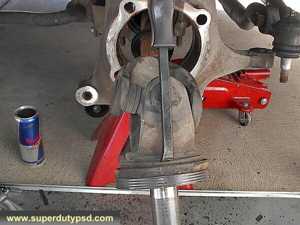

Absolutely everything was down to the last step (step 1 in the pic below) - simply "slide" the axle shaft out of the hub/knuckle so you can undo the two nuts holding the ball joints to the axle housing.

got to this step [1]:

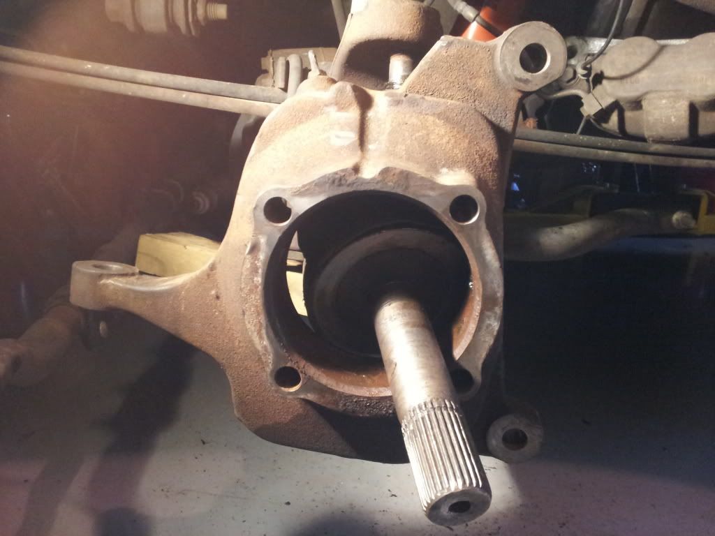

Axle only slid 1/2" to here:

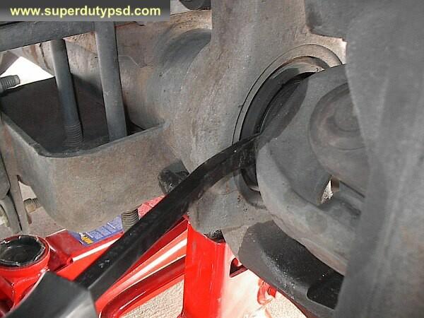

cannot get to step [2] here:

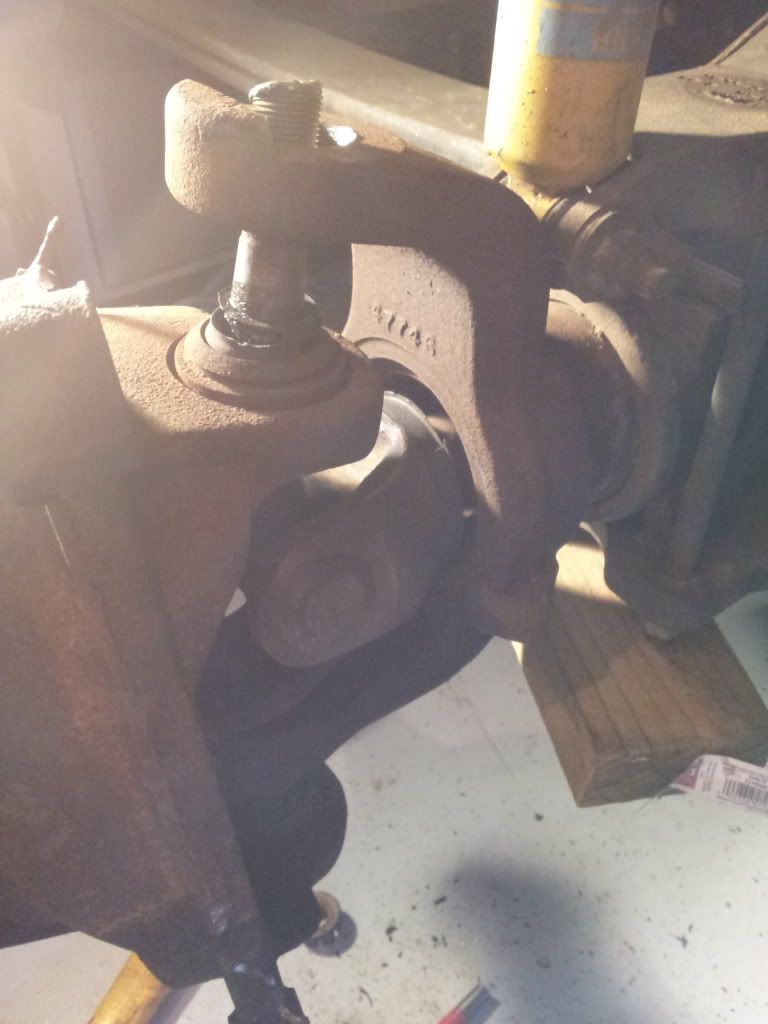

Here is how she sits:
Tried every way to force it out, eventually the balljoints gave enough that the axle slid out BEHIND the knucle. Balljoint nuts are free and the knuckle will almost slide out - but axle is keeping it stuck in place.

Well, I got it. Hopefully this thread helps somebody else in the future - my axle seal retaining ring was caught on a "lip" of corrosion (the only explaination I can offer) so it wouldn't slide out, only in. This made removing the knuckle with the axle in impossible with the balljoints in the way. I cut the top of the upper ball joint off, was able to remove the knuckle, then the axle slid out like butter.
I dont know any other way to do it than to cut off the balljoint, made it easy. What a PITA for a stupid little problem :/
