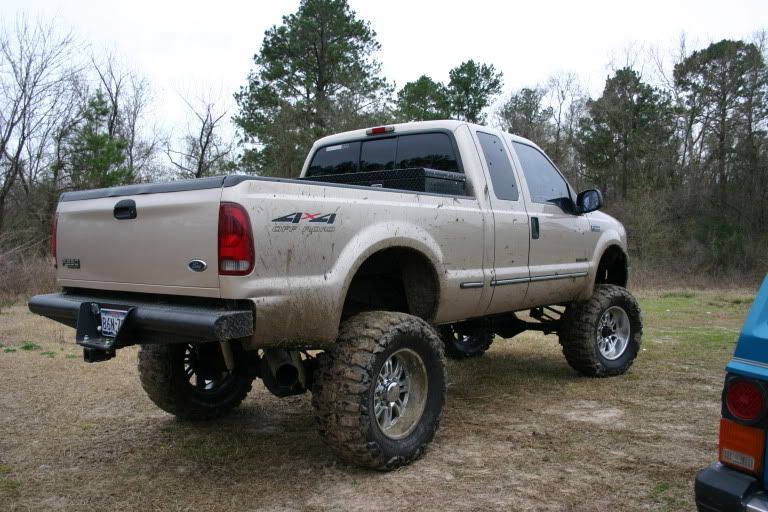

46" tires under a 12" lift will be a tight fit. Be prepared to trim your fenders and bumpers a little. Here is mine with 12"s and 38x15.50x20
