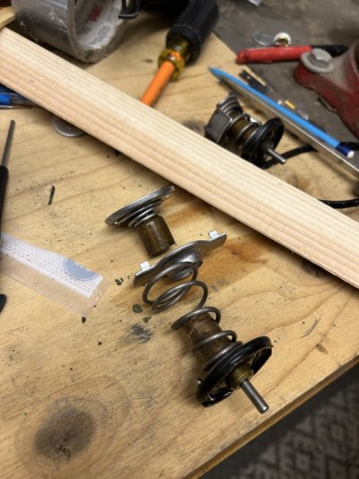

That is until I got stuck in the snow last month and had the truck idling while I waited for my retrieval team to help pull me out. When I got back in the truck my oil temp had dropped to 170º which indicated I must have a thermostat problem. After pulling the stat housing and putting it on my bench I could see the back of the high flow thermostat had moved away from the housing. The thermostat had hyper extended. I had a warm feeling in my heart that this was probably the problem all along and kicked myself that I didn't change them with the cooler relocation kit but since they had been changed less than 50K and the ones before had over 125K and looked perfect why waste the extra $$$.
Problem has been solved and all I can surmise is the high rpm from dynamic breaking down the mountain passes through Lassen must have blown it apart, (see picture below). So happy as she has always been my daily driver. Deltas are back to the previous numbers and I don't dread driving the truck knowing there still was a problem.
