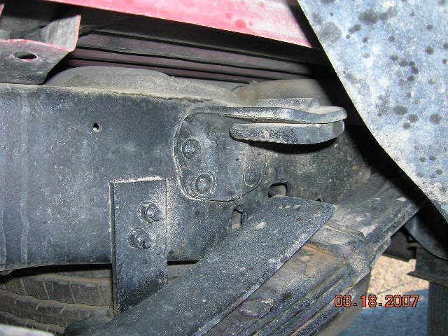

Overloads with 50 psi in the bags:

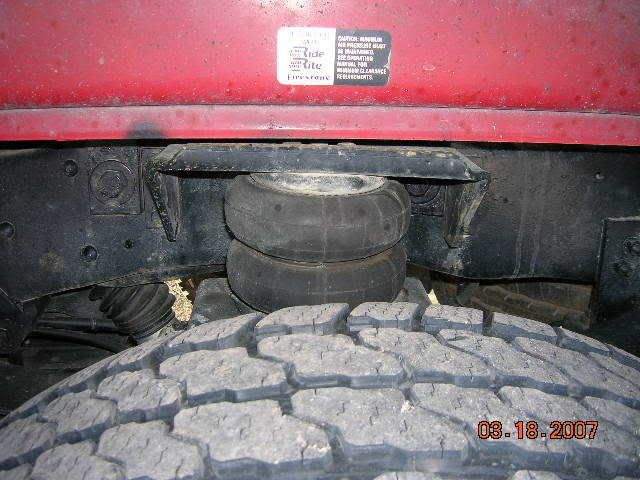

Airbags with 50psi:
Side view - hardly squats at all:

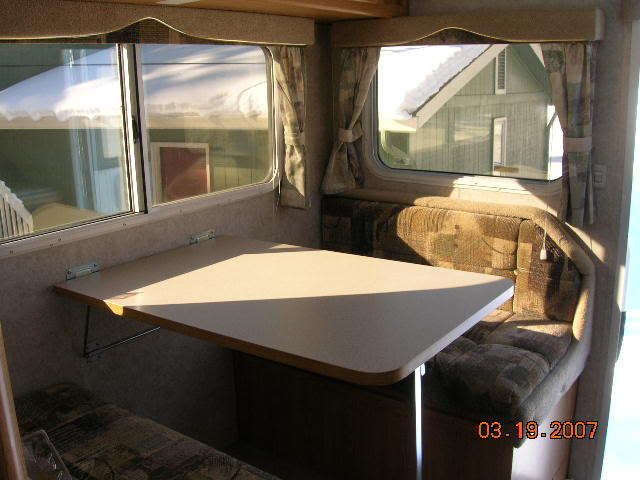

i would love to see some pics of the interior if you dont care. thanks.
does a camper like that have a good bit of room inside?
This one does have a fair amount of room for a 9'4" camper. It ain't like a T/T but it is fine for overnight trips with the family. Place to eat, sleep and a restroom for the wife. You can see the floor plan HERE. We picked this floor plan as it is one of the few that have a straight floor. With three kids one will be on the floor and most campers have a floor that goes around the bathroom and over to the kitchen, you would have to sleep in a S. There are campers available with a overhead bunk over the dinette but our kids are too big for them, they are made for toddlers. With the front bathroom we can get to it during the middle of the night, with a rear bathroom access is limited when the lower bed is out.
i would love to see some pics of the interior if you don't care. thanks.
Will do once the weather warms a little. I turned the heat off when we got home and I imagine it is a bit chilly in there for a photo opp...
