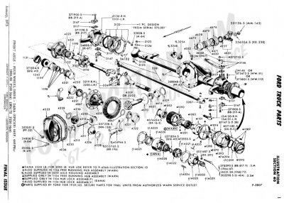

Have you checked the u-joint on the front haft shaft driver side behind the hub. Look at 3220LH in the photo that is what I'm talking about. This u-Joint will drive you nuts trying to find the problem. This is a Dana 44 front end pic but you get the idea.
