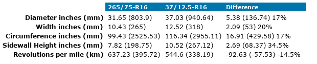

Is anybody running 37 inch tires with stock 373's gears? I did the reverse math and my final drive ratio is 3.00 with my stock 373's. My truck has 4r100 and I drive about 700 plus miles per week so I'm trying to improve my milage, I was told that if I put 430's in it will get me very close to the original ratio and should improve my milage. Lately I've been getting 12.6 to 13.2...

have you recalibrated your spedometer/odometer for the larger tires? if not then you're getting better mpg than you think. based on factory tire of 265/75/16 circumference of 100" roughly and the tires in your sig with a circumference of 116" you're traveling 16% farther than the Odometer thinks you are consuming the fuel you actually measured (14.5 - 15.3).
Better mileage is better mileage regardless of where you start from so let's figure out how to help your mileage, but don't leave out return on investment (ROI) time.
Factory gears are set for a compromise between towing capacity and fuel economy and acceleration. If you're driving highway miles then I would consider looking @ 4.10 gears which were available as a factory option so salvage yard pieces are an option heck you can get a rear and just keep it out of 4wd and test it for a week or two. If you like it then you're in less than R&P, setup kit, & setup. With the 4.10 you will keep the longer legs on the highway with reasonable acceleration. If you're not towing then keeping the OE gearing is not the most fuel efficient erring on the side of slightly taller (numerically lower) gear tends to yield better cruising economy. I can say that in my switch from 33 to 35's with my 4.10's yielded slightly better economy calcs with a non adjusted odometer which are even better when I consider the tire diameter calculation. Given the air you're displacing 15-17 @70-75 is about where you're going to peak.
