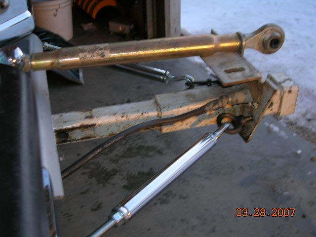

500/5000 will more than support what I am up too :sweet
Here is a picture of the idea. The upper link will help support the tongue weight of the trailer. The superHitch truss does the same thing but that setup is over $1000. I still need to build a new extension that is a little longer and shorten the link but I think this will work out and not cost anything but my labor. Off to make it happen........

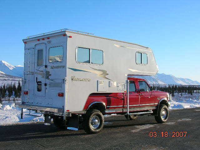

what are you gonna hand out there on the front end? i'm havin a hard time wondering what it could be?
maybe a porta potty with marble floors and walls, with a gold plated john???
Thats the back of the truck. The hitch extension is so the hitch will reach out under the back of my new 9.5' camper.
Here is a picture, see the back of the truck?
